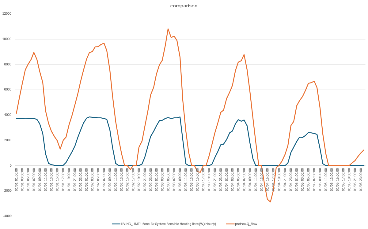

Hello, I am a beginner in Modelica. I am trying to model a single-family house using Modelica with buildings library. Further, compare the results with EnergyPlus, but the heating loads do not match well. (Specifically, I am comparing the output from modelica preHea against the EnergyPlus Zone Air System sensible Heating rate) I am aware of the co-simulation approach with EnergyPlus using Spawn, but my goal is to implement the model purely within Modelica.
I would appreciate any advice on what I might have missed or done wrong in my modeling. Thank you in advance.
Link Link contains model file(.mo, .idf), weather file(.mos, .epw), schedule(.txt) and resultresult https://drive.google.com/file/d/1r5H15yS4fmCwWElm-nvnkVv0KyRR7b2x/view?usp=sharing image description
buildings lirary 12.0.0, EP 23.1

I am trying to model a single-family house using Modelica with buildings library. Further, I want to compare the results with EnergyPlus, but the heating loads do not match well. (Specifically, I am comparing the output from modelica preHea against the EnergyPlus Zone Air System sensible Heating rate) I am aware of the co-simulation approach with EnergyPlus using Spawn, but my goal is to implement the model purely within Modelica.
Link contains model file(.mo, .idf), weather file(.mos, .epw), schedule(.txt) and result https://drive.google.com/file/d/1r5H15yS4fmCwWElm-nvnkVv0KyRR7b2x/view?usp=sharing image descriptionhttps://drive.google.com/file/d/1r5H15yS4fmCwWElm-nvnkVv0KyRR7b2x/view?usp=sharing
buildings lirary 12.0.0, EP 23.123.1 image description
