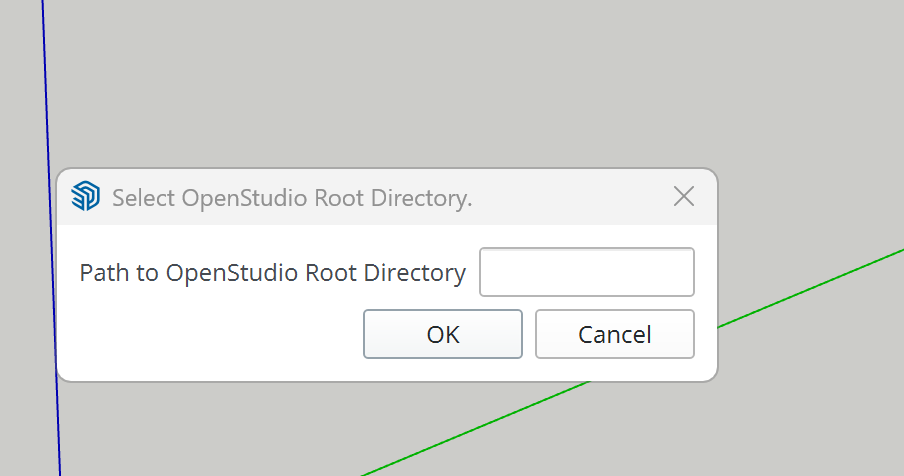

Hi,
I have successfully installed the SketchUp Pro (2023) and OpenStudio Application (v3.6.0). Following this, I installed the OpenStudio SketchUp Plug-in which was as per the compatibility matrix provided on OpenStudio Coalition website (https://github.com/openstudiocoalitio...).
Compatibility doesn't seem an issue here but when I open SketchUp it gives me following prompt:
"Select OpenStudio Root Directory"
Even when I specify the root directory it still throws an error: C:/Ruby/openstudio_modeleditor.rb does not exist.
I am not sure why it says that.
Any solution to this will be appreciated.
Thanks and Regards

I know it's confusing, but you must install the OpenStudio Application, not the OpenStudio SDK.
Re-read the wiki at: https://github.com/openstudiocoalitio...
Get the 1.6.0 from https://github.com/openstudiocoalitio....
The OpenStudio Application 1.6.1 will also include internally the OpenStudio SDK 3.6.1, so no need to install it separately. The OpenStudio Application has - in addition to the Graphical User Inferface - special ruby bindings that the OpenStudio SDK does not have, and that the openstudio-sketchup-plugin needs to work.
Point the OpenStudio Root Directory to C:\openstudioapplication-1.6.0 once you have installed the OpenStudio Application 1.6.0.

Greetings All, I will chime in here for I like this forum. Seems to be good people looking for good answers. I recently followed the OpenStudioCoaltion's Installation and Introductory Tutoriallink texthttps://openstudiocoalition.org/getti... I tried the installation of OpenStudio-Sketchup-plugin versions v1.10.0 and V1.9.0 and had the self-inflicted errors during initial and subsequent launches of SketchUp Pro 2025 of a bad "Path to OpenStudio Root Directory" popup. When I initially installed the OpenStudio-Sketchup-plugin and was prompted to enter the image description I simply used Windows 11 File Explorer to Copy/Paste the [Path to the OpenStudio Root Directory] prompt box. This was:
  • List item "C:\OpenStudioApplication-1.10.0+14257a978b-Windows" and in the first case was
  • List item "C:\Program Files\OpenStudioApplication-1.10.0+14257a978b-Windows"
The use of "\" in the Windows environment and its use in the OpenStudio and SketchUP environments are seemingly not compatible. Changing the [Path to the OpenStudio Root Directory] to:
  • List item "C://OpenStudioApplication-1.10.0+14257a978b-Windows" and/or
  • List item "C://Program Files/OpenStudioApplication-1.10.0+14257a978b-Windows"
...this seemed to cure the self-inflicted injury.
This was seen by inspecting and understanding the Error report and the "Malformed version number string..." and noticing the use of "/" rather than "\". A simple syntax error within different coding environments or whatever you call them:). Although, I could be wrong.
Extension Errors Report SketchUp: 25.0.660 OS: Windows 11 Ruby: 3.2.2
Extension: OpenStudio (1.10.0) Error: ArgumentError (Malformed version number string C:/OpenStudioApplication-1.10.0+14257a978b-Windows) C:/Program Files/SketchUp/SketchUp 2025/SketchUp/Tools/RubyStdLib/rubygems/version.rb:223:in `initialize'
Everything is working good now.
