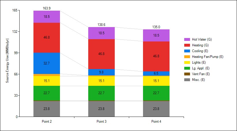

BEopt supports modelling the partial air conditioning of a home by selecting/setting an option with an "Energy Multiplier[frac]" less than one. The name of this parameter implies that it simply scales the energy use of the RAC(s) relative to 100% coverage, whereas the help file is a bit more nuanced.
Room air conditioners are modeled as conditioning the entire finished floor area. This multiplier can be used to adjust the cooling energy use to account for, e.g., when the system does not condition the entire living space.
How is the energy modelling for these partial load installations handled? I ask, because a quick check of the energy consumption of three RAC options with the same efficiency but different coverage produces some non-intuitive results. As can be seen below, they certainly aren't a simple percentage of the 100% coverage energy consumption, but they also do not show any moderating effects from partition walls potentially being at less extreme temperatures than ambient walls.

The intent of the Energy Multiplier is indeed to scale the energy use of the RAC(s) relative to 100% coverage. I created a simple new construction home in BEopt 2.8 that gives perfect results (for 100% vs 30% vs 20%):
That said, I can confirm in your retrofit case that it is not coming out that way and looks to be a bug. I think the issue is that the room air conditioner in the 100% case is being undersized, so its consumption is lower than it should be. If you look at the 20% and 30% runs in your graph, it does look like the 30% run consumption is 1.5x the 20% run consumption. Since BEopt 2.8 is more than 8 years old, it doesn't make sense to investigate further as there are no more bugfixes for that version, but I will plan to see if BEopt v3 is similarly affected.
