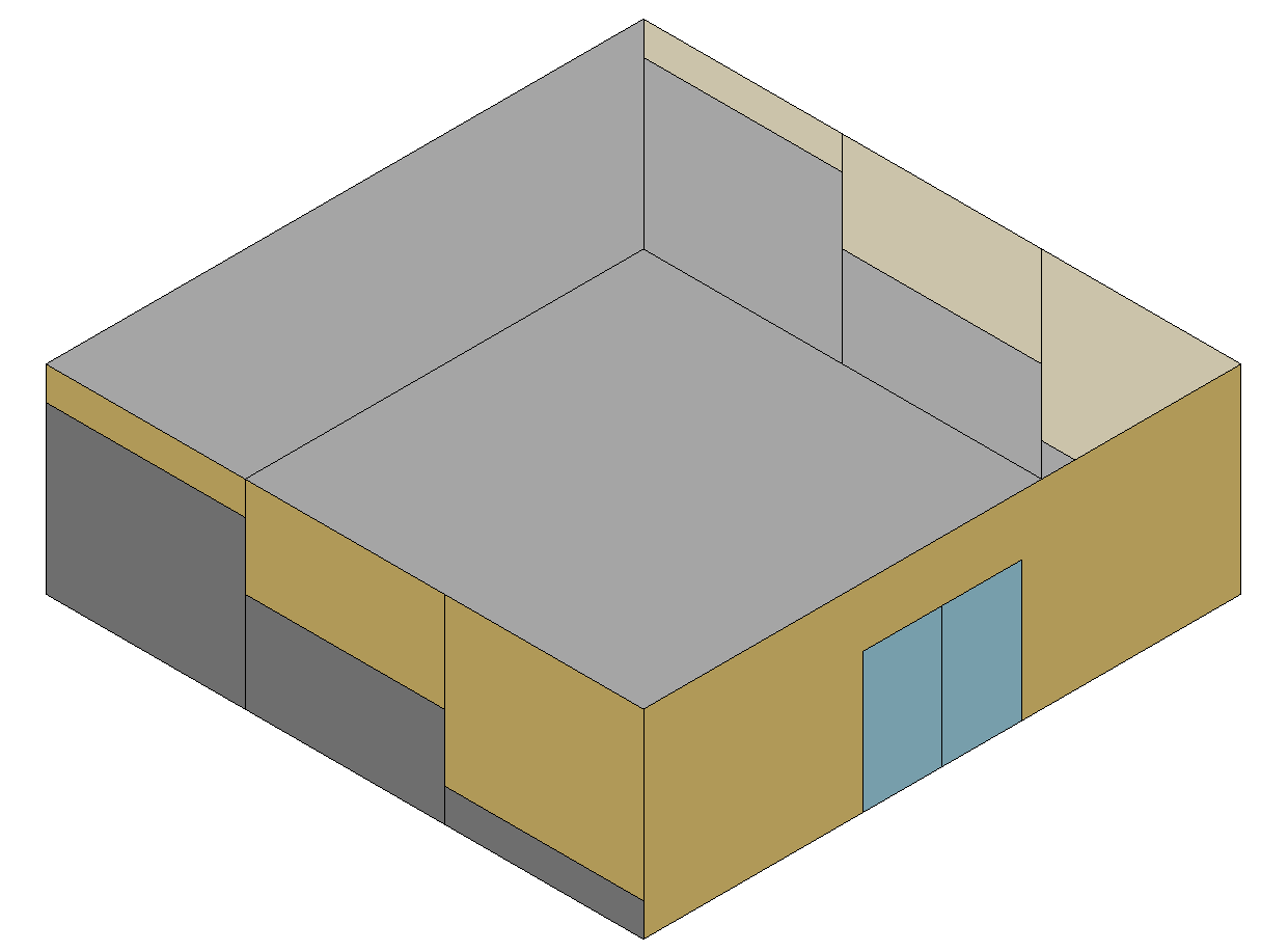

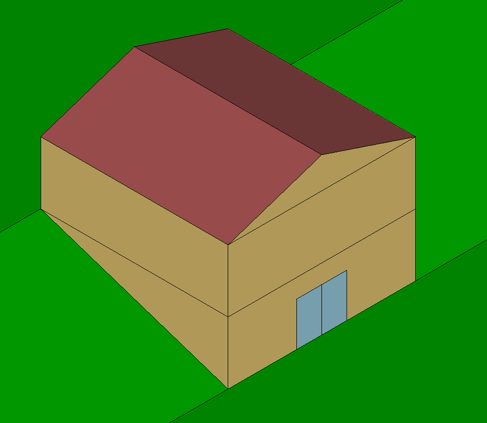

Hi, is there a way how to simulate cooling load of partially underground floor? You know what I mean a bunker-like residential building with a lot of windows in just one wall heading to the south (or SE, SW...). Can I do it with cooperation with sketchup plugin and Openstudio?
answered 2026-02-09 09:56:18 -0500
It sounds like you are referring to a walkout basement. The best model in EnergyPlus for this foundation type is Kiva. In fact, if you look at its inputs, it specifically describes how to model a walkout basement using multiple Kiva foundation objects with stepped wall surfaces.
Unfortunately, the OpenStudio Application does not support Kiva right now, so you would need to:
  1. Add the Kiva inputs directly to the EnergyPlus IDF input file, or
  2. Use the OpenStudio SDK to programmatically add the Kiva inputs
Generating KIVA inputs can be done in OpenStudio using the TBD measure (see UMH post). Manual editing of some of the generated parameters is likely required, as described in the post.
