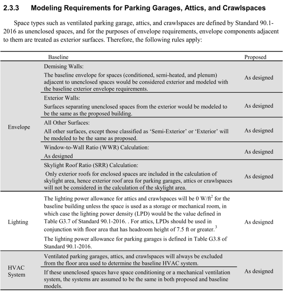

You can refer to PNNL 90.1 Performance Rating Method Reference Manual.
A parking garage with a heating system is an unenclosed space. The geometry, lighting power and HVAC system shall be modelled.
