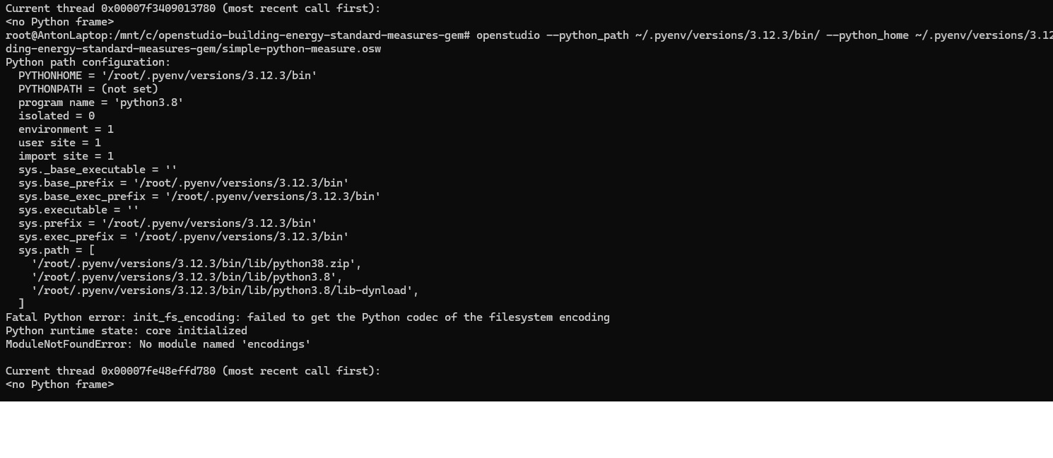

After trying the suggestion below by Jeremy
openstudio --python_path ~/.pyenv/versions/3.12.3/bin/ run --workflow /mnt/c/openstudio-building-energy-standard-measures-gem/simple-python-measure.osw
I am able to run the .osw with python however the site_packages for python are not there.
When I try to set Python Home however I then get this error
How to add pip packages/Ruby gems to a OpenStudio workflow (.osw)
openstudio --python_path ~/.pyenv/versions/3.12.3/bin/ run --workflow simple-python-measure.osw
I am able to run the .osw with python however the site_packages (pip packages) for python are not there.there even though they are there when I just run them with python
I am able to run the .osw with python however the site_packages (pip packages) for python are not there even though they are there when I just run them with python
When I try to set Python Home however I then get this error error, I am still digging into this
I am able digging deeper, just passing python home to run the .osw with python however the site_packages (pip packages) directory where a pip package is contained worked for python are not there even though they are there when I just run them with python
When I try to set Python Home however I then get this error, I am still digging into this
image descriptionme

---- EDIT and Solution
After digging deeper, just passing python home --python_home to the site_packages directory where a pip package is contained worked for me
After digging deeper, just passing --python_home--python_path to the site_packages directory where a pip package is contained worked for me
After digging deeper, just passing --python_path to the site_packages directory where a pip package is contained worked for me
For example this command -
openstudio --python_path ~/.pyenv/versions/3.12.3/lib/python3.12/site-packages run --workflow /mnt/c/openstudio-building-energy-standard-measures-gem/simple-python-measure.osw
