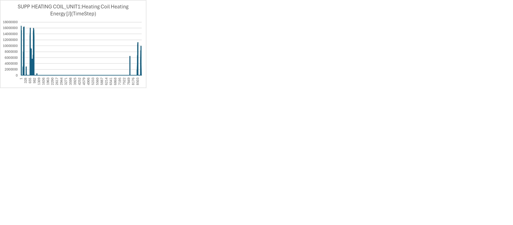

Hello,
I am using a Coil:Heating:DX:SingleSpeed to simulate a heat pump conditioned building. The building is a IECC 2006 prototype building model. The building model has been modified to remove all domestic hot water distribution loop. Special modification is done on the Supplemental Heating Coil to make it a hot water based one using the Coil:Heating:Water object. A plant loop has been created to supply hot water to the supplemental coil to respond to any supplemental heating demand request. However, when I run the simulation, the supplemental coil is not responding. Zone temperature (LIVING_UNIT1) is falling abruptly when heat pump is unable to satisfy load. I am uploading the .idf file here. I will appreciate any expert opinion on this. Thanks.
-Abir Ahsan

I was able to get the supplemental water coil to turn on but only by changing the software. I am not sure what is happening here. The fact that there is only 1 HW coil on the demand side of the loop should not be an issue. The plant is simply setting the water flow rate to the coil to 0 so the coil does not turn on. If I trick the software the coil does turn on. So this will take more investigation to figure out what is wrong. i.e., something in the input file (I don't see anything) or something in the software. I see that there was a fix for supplemental water coils used in AirLoopHVAC:UnitarySystem for 24.1 here so maybe you could try using that parent object?
