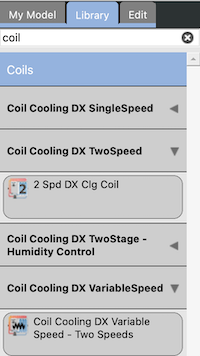

As an example, maybe you're interested in EnergyPlus' Coil:WaterHeating:AirToWaterHeatPump:VariableSpeed object. This is indeed supported by the SDK (see here and here). Yet it doesn't look like it's supported by the App - I could be wrong. A search for "coil" suggests the App is limited to DX (you can also search for "HP"):
Based on the search results, I'd suggest the best option is indeed an OpenStudio Measure - in this hypothetical example, based on the aforementioned VSD object.
