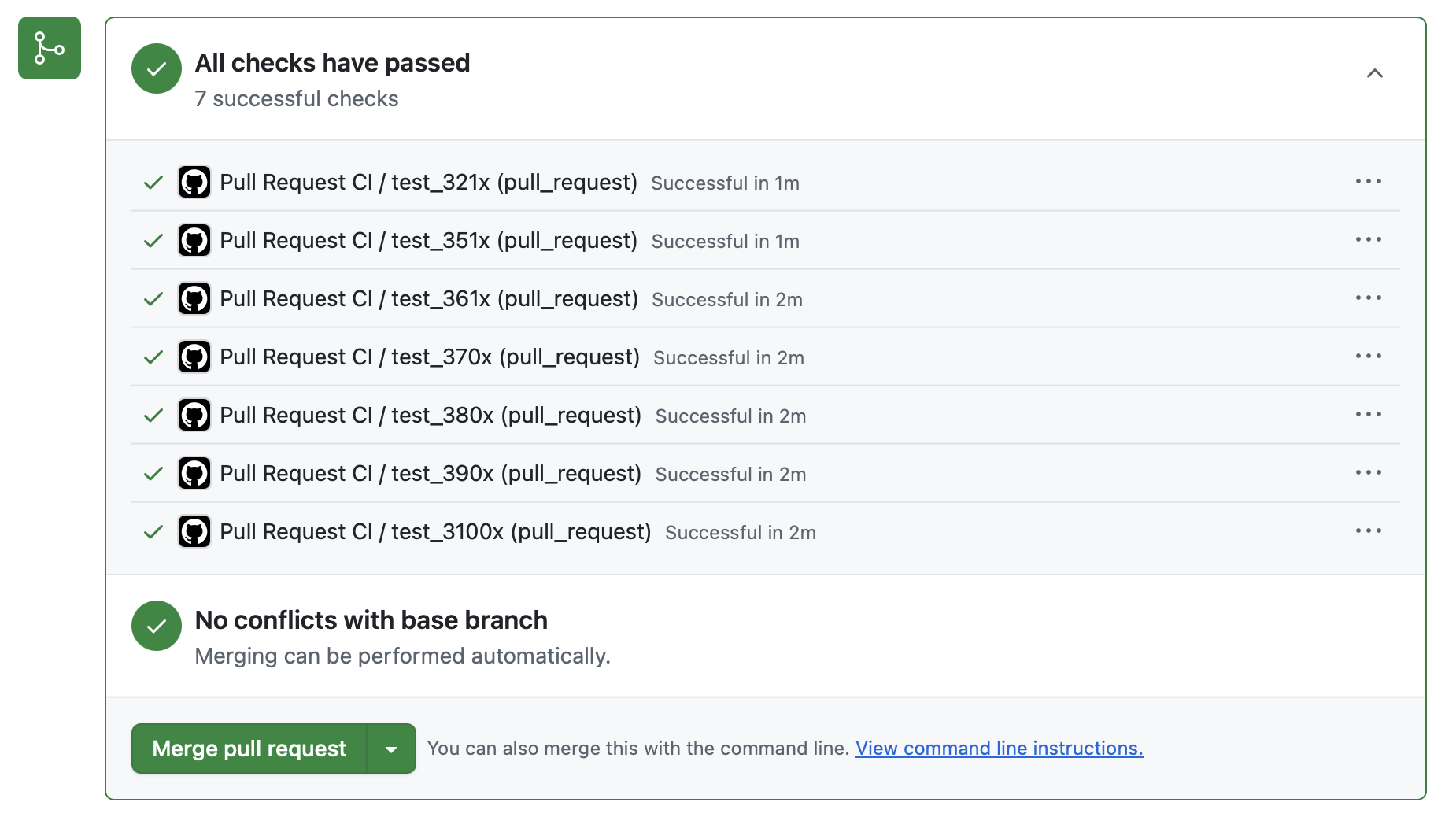

Question 3: With every change we consider bringing in, TBD is systematically tested against multiple OpenStudio versions, from v3.2.1 to the latest OpenStudio release. We do the same with a separate testing repo.
TBD adapts to the OpenStudio version you're using. So you can use the latest TBD release with OpenStudio v3.2.1, for instance.
