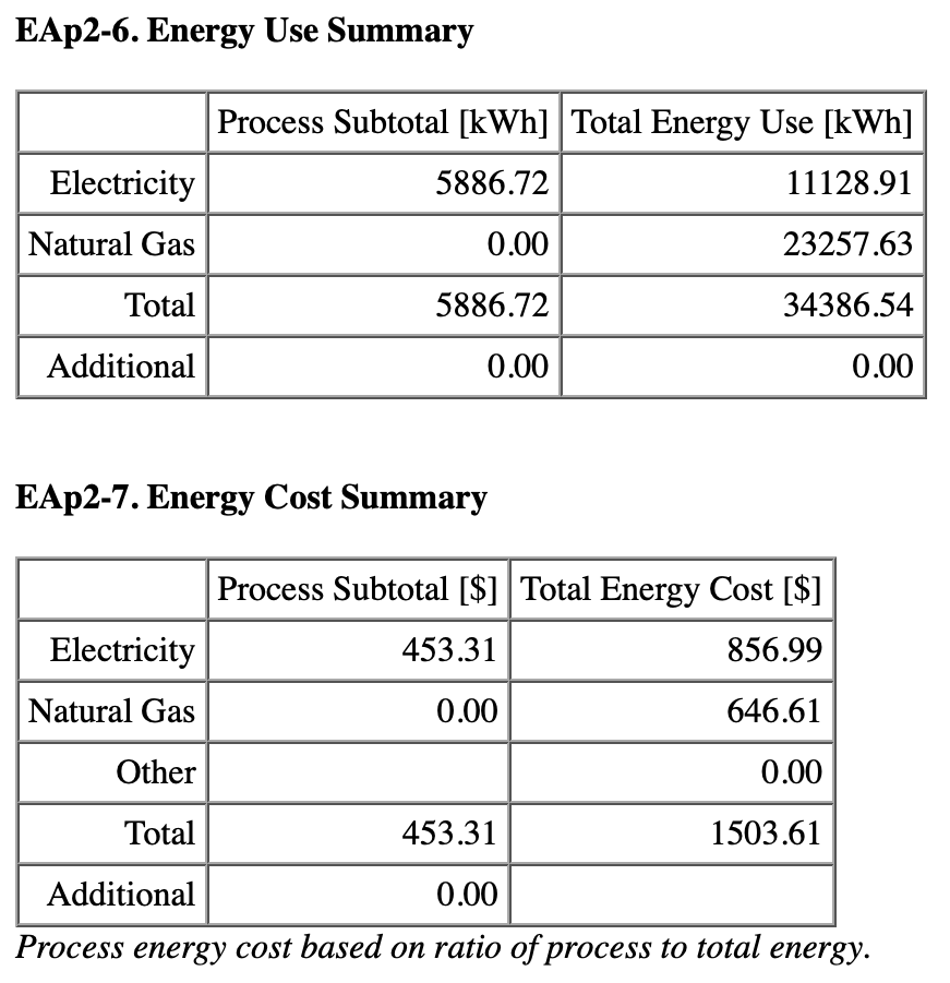

This generates the following in the eplustbl.htm file (or .html file):

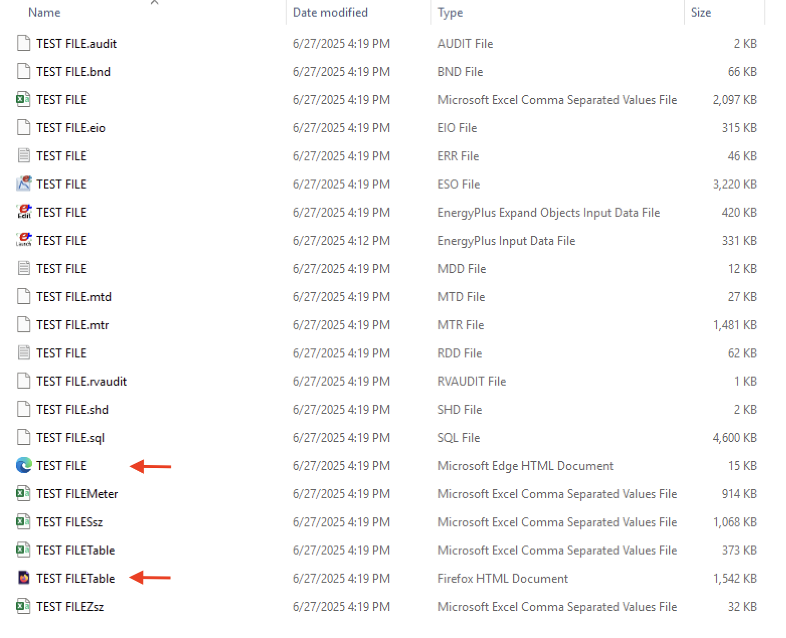

EDIT: Not sure which .html file here (your recent screen capture) corresponds to the usual eplustbl.htm file:

I have made the changes; but, I do not seem to have a eplustbl.htm file. However, I did notice some changes when compared to my previous simulation.
  1. When I make the OutputControl:TableStyle, CommaAndHTML or TabANDHTML. I do get an additional file of my results stored as CSV or Notebook.

@Manny, I brought in some minor edits to my original answer:
  • CTRL-F "Energy Cost Summary" in either of the generated .htm or .html files. I just ran your updated .idf: Got the same operating costs (for both electricity and natural gas), as shown in my initial answer.
