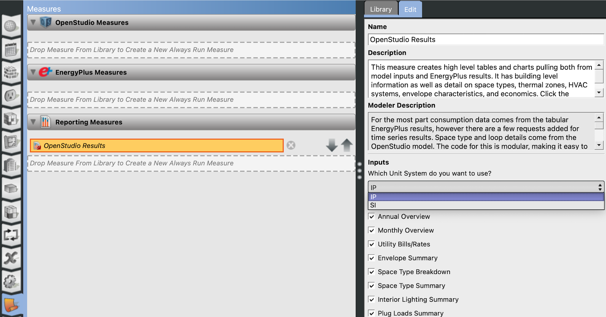

ı m trying to run my simulation in si units. however, BCL library does not have in QAQC. so, I try to add new library as in manually, but it did not work either. What should I do?
EnergyPlus always runs simulations in SI units (e.g. J, W, kg). Are you instead referring to the OpenStudio Application or SketchUp Plugin interfaces (i.e. input)? or are you seeing results (i.e. output) generated in IP units? Or are you instead referring to the OpenStudio Results reporting measure? Each of these have SI vs IP toggles. So which tool and which issue are you coming up against, specifically?
Denis Bourgeois's avatar Denis Bourgeois  ( 2025-05-23 11:05:08 -0500 )edit
Open studio application, the model results of BCL, I dont see any toggles, I try to add new BCL library from outside but did not work. The simulation failed. There is a set units si for energy plus and my preferences are si unit. however results and graphics are in ip units.
ecem's avatar ecem  ( 2025-05-23 13:16:21 -0500 )edit
answered 2025-05-24 06:52:30 -0500
updated 2025-05-28 07:32:17 -0500
I may be wrong, but it sounds like you simply want the OpenStudio Results measure to report results in SI units. As documented here, you can toggle between SI and IP in the very first input selection "Which Unit System do you want to use?".

Tested this using OpenStudio Application (App) v1.9 - no issues.
It is true that (much) older versions of the measure did not offer this units toggle - see here. But recent releases do - see here. Which version(s) of the App are you using? If you're not seeing the units pull-down option, you may be using a fairly old version of the measure. If so, consider upgrading.
There is definitely an issue with the measure when dealing with OpenStudio SDK v3.8, as discussed here and here. No issues with the latest SDK v3.9 (i.e. App v1.9), though.

that screenshot just saves my thesis, and my time, I just missed that toggle, I mean I try to add library, wrote library from scratch etc. thanks a lot.

Glad that's working for you. I tried adding the screenshots when I first answered, but for some reason I couldn't initially load them up (UMH issue, I suspect). Side note: if you find the answer acceptable, it's customary to accept it by clicking on the checkmark - helps others in the future.
