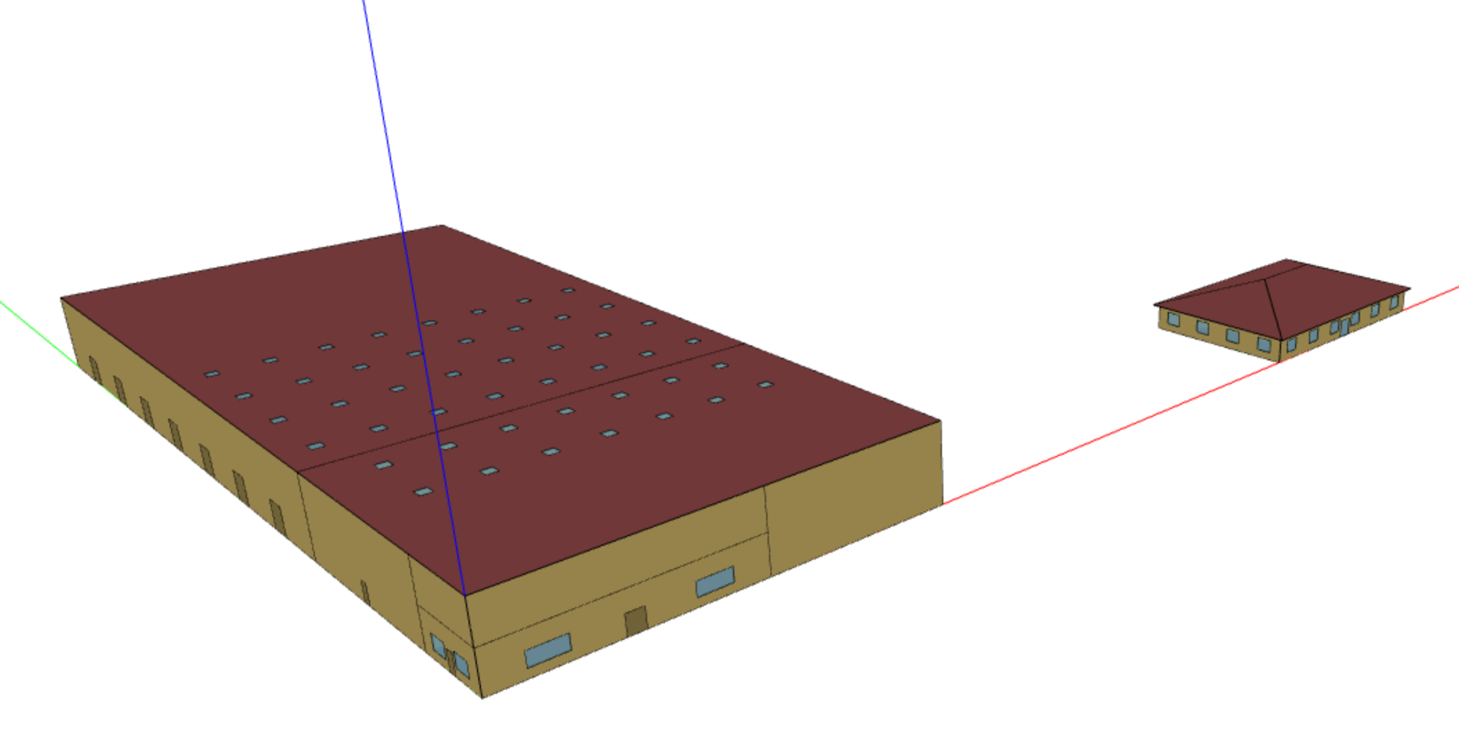

Running the script generates a "final.osm".
No errors running a test simulation using the App. You do need to first assign a (complete) default construction set to the building to actually run a test simulation. You can adapt the script to your needs (e.g. use your own OSMs). If needed, you can email me the (zipped) OSMs - I'll merge the zipped OSMs using the very same script.
