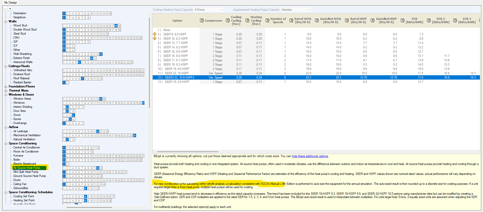

Hello,
When modeling new construction residential models, BeOpt includes a note regarding the capacity of the system being sized per ACCA Manual J, I wonder if there's a way to regard that autosizing calculation, or if the overall size of the system can be seen/found somewhere?
I'm struggling pinning down that information for a variable speed heat-pump system (woking with BeOpt 2.8).
Any assitance would be appreciated!C:\fakepath\Autosizing 1.png(/upfiles/17466627125362091.png)(/upfiles/17466626984348892.png)

The autosized HVAC capacities are found once you run on the simulation on the output screen. Right-click on the End Use graph (lower-left graph) and choose Graph Type > HVAC Capacities. You'll see something like this:
A few notes:
  • You should really consider using BEopt 3. BEopt 2.8 was released over 7 years ago. There have been significant improvements to our heat pump models (especially variable-speed) in BEopt 3, with more pending. In addition, BEopt 3 allows you to see the design loads by component (walls, roof, infiltration, etc.) that were used to autosize the equipment.
  • While the design load calculations are consistent with or based on Manual J, BEopt is not an ACCA approved software tool.
