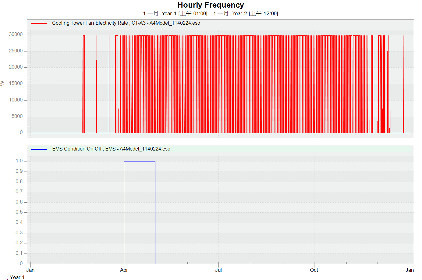

I am trying to use EnergyPlus's EMS system to control the on/off operation of a cooling tower. I would like to first try turning off the cooling tower with the ID CT-A3 in April. I checked the eplus.edd file to confirm which actuators I can use, and the following is my relevant code:

I output a global variable to verify whether EMS is set up correctly. As shown in the figure, even though EMSOperateConditionReport equals 1 in April, the cooling tower still has not been turned off as configured.
I have also tried using different ProgramCallingManagers, but still haven't been able to turn off the cooling tower.
May I ask what might be causing this issue? Thank you very much for your assistance.
