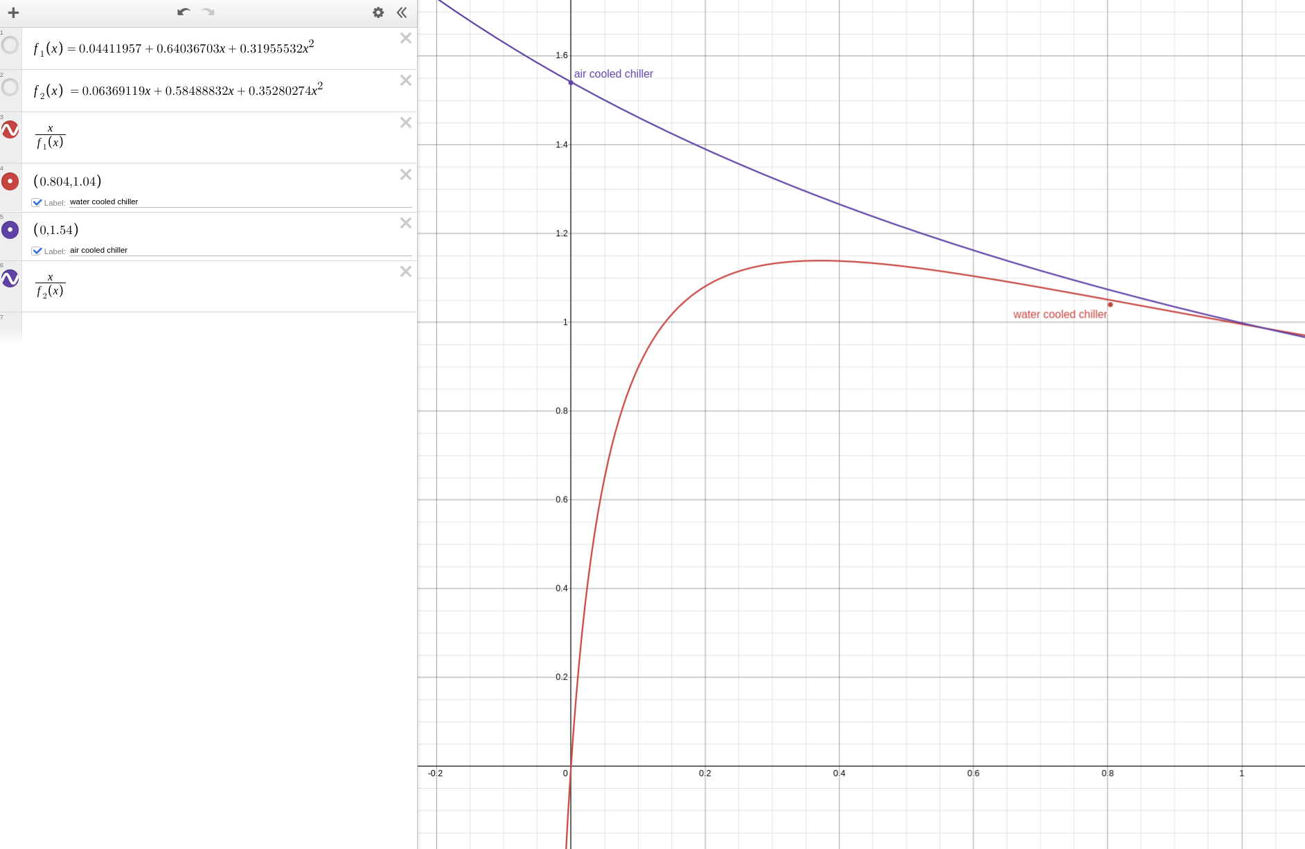

I'm comparing the COP of air-cooled and water-cooled chillers using the COMNET EIRFPLR curves
I plotted both chillers' COP using Desmos for both scroll type chillers:
Given that both chillers have the same nominal COP (1 in this case), I expected the water-cooled chiller to perform better. However, the curve suggests that the air-cooled chiller has a higher COP across all part-load conditions.
This seems counterintuitive since water-cooled chillers are generally known to be more efficient. Am I misunderstanding something about the EIRFPLR curves, or is there another explanation for this result?

EIR means energy input ratio, this is the inverse of COP. That might explain it. Instead of plotting COP, did you plot EIR?
Greg Estep's avatar Greg Estep  ( 2025-02-06 12:22:47 -0500 )edit
i went with the explanation given by @ericringold in this post assuming nominal EIR as 1 the hourly EIR is EIRFPLR/PLR and so the cop must be PLR/EIRFPLR. the formula are written in the left-most side of the image where x represents the PLR.

Your f2 has an extra x multiplying the 1st parameter
oh man i sat on this for so much time, well thank you hahaha. the post may be deleted i guess
