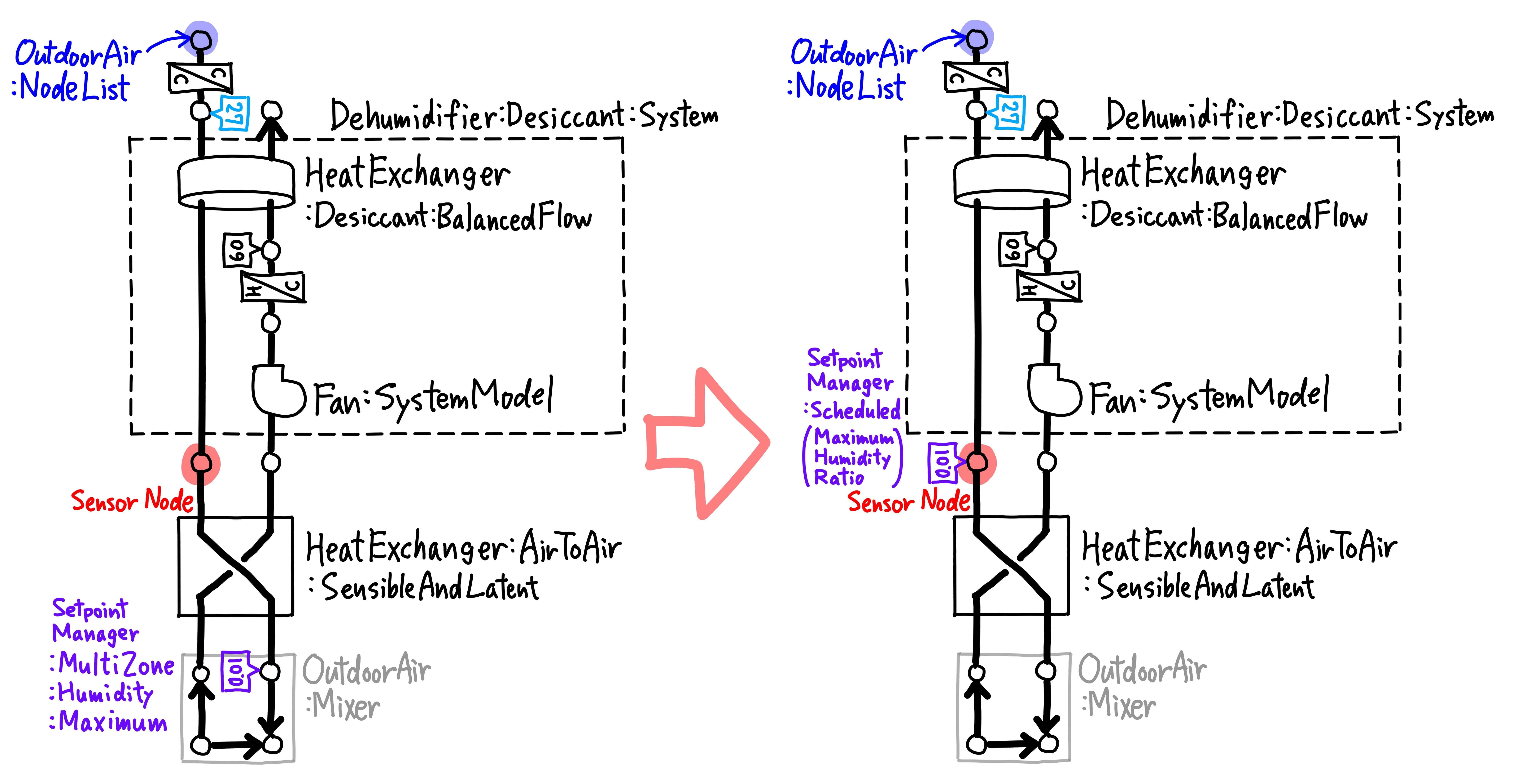

Self-resolved. I updated the idf file to V25-1-0, and it no longer crashes. An err file was generated.
   ** Severe  ** Missing maximum humidity ratio setpoint (MaxHumRat) for
   **   ~~~   ** Dehumidifier:Desiccant:System: PAU_3-14_TENANT DESICCANT SYSTEM
   **   ~~~   ** Node Referenced=PAU_3-14_TENANT HEAT RECOVERY SUPPLY OUTLET
   **   ~~~   ** use a Setpoint Manager to establish a "MaxHumRat" setpoint at the process air control node.
   **  Fatal  ** Previous severe set point errors cause program termination
The cause was that I was careless and put a setpoint manager for max humidity ratio to a wrong node. The simulation completed successfully after the location of the setpoint manager was revised.
