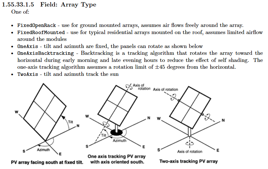

The PVWatts model has the ability to model one axis and two axis rotating arrays. See the Array Type field.
