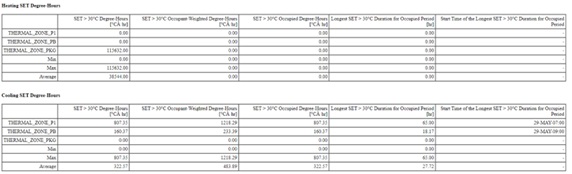

I believe there is a mistake on the Heating SET Degree_Hours Table. On columns header appear “SET > 30ºC Degree-Hours” but in reality should be “SET< 12ºC Degree-Hours”
Am’I wright or wrong? I’m using OpenStudio Application v.1.9.0 and EnergyPlus Engine v.24.2.0

Headers column for Heating SET and Cooling SET are identical, up to me it’s not correct image description
In Input-Output document it seems for heating it’s necessary to use 12ºC as threshold value and not 30ºC
